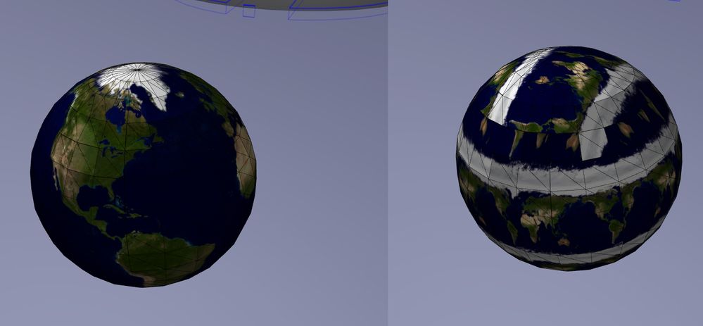

I liked the Google warehouse idea, so I tried it since manually drawing continents and SEO them out of the shell is way too much work for now.
Unfortunately after I import the file the object is fine, but when I convert it to a morph it changes...
I have added screenshots so you can see what I mean.

ArchiCAD texture mapping is very limited. As you saw, an imported object will get the UV mapping correctly, but converting or editing will break the map.
What you're showing though is a simple texture mapped globe, but your original post seemed to indicate that you were looking for a more detailed model that massed continents and left the oceans empty? Just do a Google search. I think these are more along the lines of what you're looking for?
