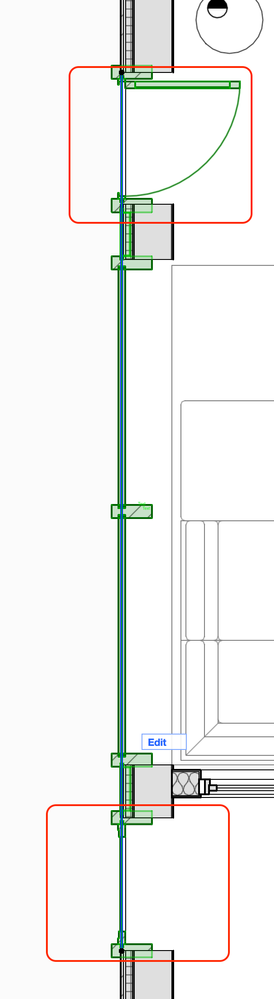

Hi All--
Been searching everywhere and tearing my hair out trying to understand why only one door in my curtain wall is showing as open. When I created the wall both doors were showing the swings, but for some reason one shows as closed now in plan. Settings the same for both doors - but only one showing swing now. Cut plans are obviously not the issue. Please see the screenshot attached with red highlight around the two door panels. Any help greatly appreciated. Could it be Monterey?
