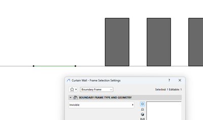

Hi all,
Is there a way to turn off the display of the "frame" when it is set to invisible? Given it is segmented into individual lines, it is not possible to have it dashed...
Ling.
Operating system used: Windows W11 24H2
1 Reply 1
Can deleting the Frames in 3D instead of setting them to Invisible be an option in this situation?
If you delete a Frame, the two Panels on its two sides will be merged into one, and that could solve this problem.
