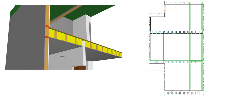

I received feedback today, mainly about the internal layout of my building. My tutor was impressed ( slightly) of the 3D drawing I made, but now all the sections are ' messy ' ( attached, and also a 3D cutaway, excuse the colours !) ) I'm thinking of using cadimage Wall framing and for the floors just use a solid slab to represent the floor thickness. Then, in section I will draw details like the Insulation, Timber joists, membrane etc. as this will be more accurate, take less time and look better.
I think my workflow needs adjusting, I'm determined to get everything done in 3D, but in reality you don't show how floors are made in 3D, hence why sections are so important. For clarification, do Architects manually draw most details and just model the floor as a solid slab ( I know how vague this sounds ! )

The floor should be a composite. If you are going to show the framing joists, then the slab composite would be just the sub-floor and finish materials. Or, finish materials can be their own slab to allow you to vary the finish material so the floor slab is just the continuous sub-flooring. This approach also lets you show MEP without having to SEO them from a floor slab, as shown in your screen shot.
The ceiling below can then be separate, allowing for different ceiling heights and you can optionally include in the ceiling the insulation.

Well in the section image in the previous post, you can see that all the joists and slabsand insulation are overlaid onto each other, and I feel that the whole section looks messy. My plans are also hard to read as they are overlaid with joists, which my tutor said you don't need to see. She can be quite confusing at times, one day she will just ask for outlines of the building, the next she wants details. I know that in the elevations I will show the cladding and windows, nothing else, then I will create sections that will show the construction method and this is where you will see lots of details. Now regarding the 3D view, I want to show something similar to the image previously posted, but that has generated a ' messy' section, so should I have the 3D model on a separate file ?

Layer Combinations are crucial to producing a good set of drawings. It Still strikes me as incongruous that for all the 3D modeling and BIM we do, are end product remains 2D drawings as it has for centuries. But I digress.
Most of us have modeling layer combinations and printing layer combinations.
The latter only have the layers we want to see printed for a particular drawing. For example your joists could be on a framing layer that would be turned off for floor plans and reflected ceiling plans. Similarly they might turned on for construction document building sections but off for preliminary design building sections. On again for framing drawings.

You chould create a view for each drawing you will be creating. With each view is saved the scale, layer combination, model view option, zoom, etc.
In your examples your building sections will most likely be at the same scale as your floor plan. You may have a wall sections that are saved at 2-3 times larger. These, like details, you will add in the 2D (annotation) information. Annotation includes fills, library part symbols, text, dimensions etc.
Notes and symbols legends e.g. lighting legend can be in your template on independent worksheets.
Details can be started right off the model (how you place your detail marker) and saved at whichever scale and other view setting options will be appropriate for that drawings.
These various drawings, the building section, wall section, detail, sheet notes, legends etc are all arranged on the layout sheet.

The easiest way to start is to keep the fills to a minimum and fill in the details in the enlarged drawings. As you get to know the program you may want to enable more automated drafting from the model, but some inherent limitations to this have kept many advanced users from this approach.
