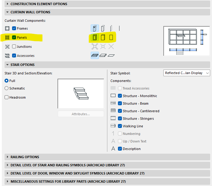

Ok, I managed to model it and it shows the pattern or grid but I can't show the ceiling with a fill and colour. No choices for how it shows in plan?
CosminF
You might want to go into your Model View Options and under Curtain Wall Options make it so that the CW panels are visible:
They should then show up in your floor plan.
Then you can make a graphic override and make them any color you want.
