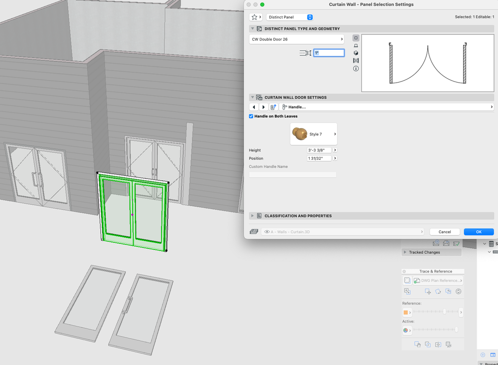

I'm using ArchiCAD 26 4022 USA FULL on macOS Monterey 12.6.2.
I have created curtain wall.
Then selected one of the panels and changed it to CW Double Door 26.
Then inside Leaf menu - I have selected Custom Door Leaf and selected my custom door leaf.
After that - door handles disappeared.
Why?
Note: it works fine with regular door objects, but not with curtain wall.

i have tthe same problem, any suggestions?

I no longer have AC26 installed but could it be a setting in your Model View Options, it usually has a separate setting for curtain wall items.

I don't know why this happens, but I can confirm the same happens in version 28.
Odd, because the handle settings are all still there.
However you shouldn't need a custom door leaf for a glass door like that.
There should be an 'Editable Glass Field' door panel that you can use (unless that is just in 28).

I tried to put a handle on the custom leaf,  but the dimensions are deformed.
