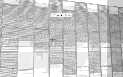

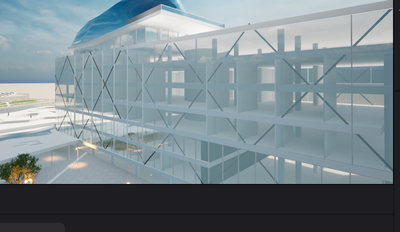

I have been doing a project with brie soleil, but since the option does not exist in Archicad I decided to make them with a modification of courtain wall, in 3d regardless of the view it is seen, the problem is when trying to render them, they disappear, I have also tried with enscape and twinmotion but they don't solve the problem either, what should I do to make them visible in the render?

Is the layer of the curtain wall set as wireframe?  Could be the problem, the layers as wireframe won't be visible in twinmotion...
