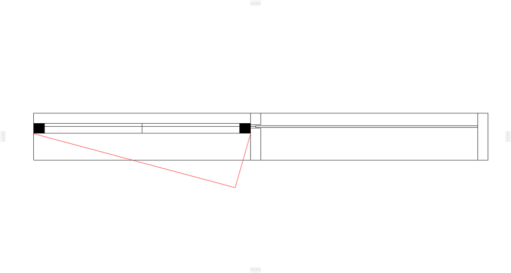

I'm testing the facade-tool (curtain wall) and can't fix some points:
- 2D-opening line of a window in the floor plan
- the window don't know the relation to the room, it takes the relation from the hole curtain wall
Some ideas to fix that?

Can you show some screenshots of the exact situation?
bimdo
gs-model: showing situation in the model
gs-floor: which line we want to see in the floor plan (opening line of the window)

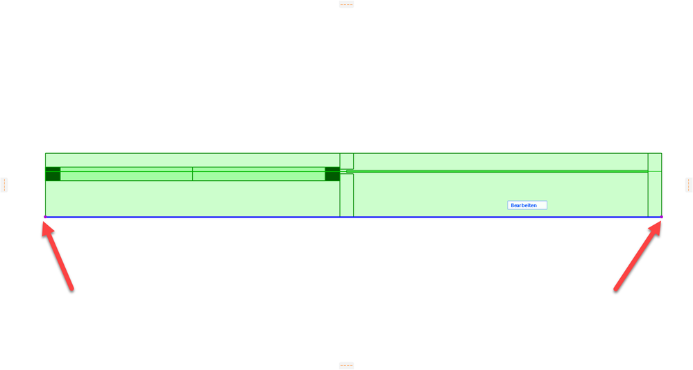

gs-fixpoint: no intelligent measure possible for the columns inside the facade, because there are no fixpoints, only at the end of the facade

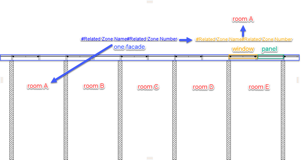

gs-related zone: If you've a facade and inside many zones, the window doesn't know the related zone, it take one zone for every element.

bimdo
the related zone is working now, have a look at this video
https://www.youtube.com/watch?v=s9k_QLDyEJg
