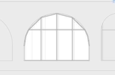

Hello there. I was wondering can I model curtain wall with curvy frame on top?

No, there is no such thing as a curved frame member in a curtain wall.
You have to make many shorter frames to give the curved affect.

I ended up doing a curved frame with a shell, then SEOing the curtain wall to that one time. Though there were multiple SEOs given it was curved in plan too...
