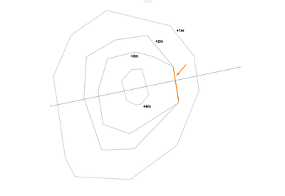

Hello,
After personal research without finding a good enough solution I come here asking:
How to model a terrain that has some contours overlapping (meaning they have same x,y but different z = the terrain has a vertical cut)??
Example diagram here:

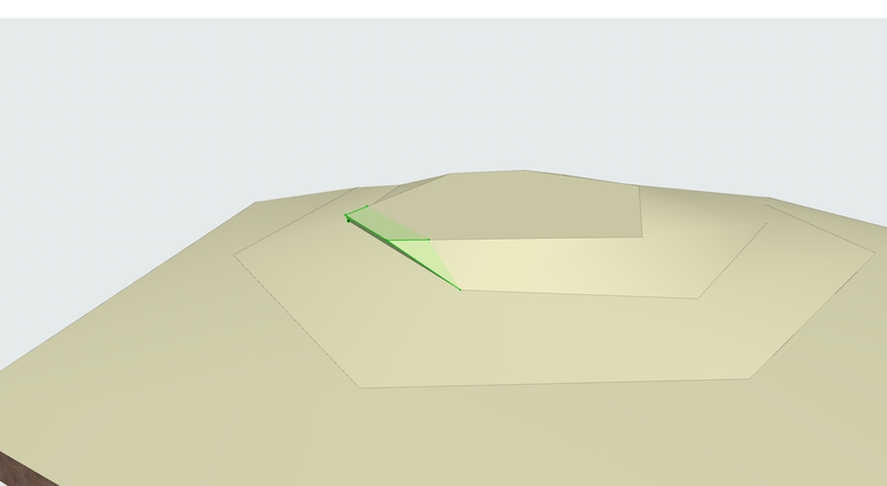

...If this is modeled the "correct way" = creating mesh > creating the contours on the mesh > elevating each contour to the correct Z, then the outcome will be this one:
The problem is that the points that belong to the both contours cannot be the one above the other, they are merged...
And the solution cannot be to "cheat" the modeling by moving the one contour 1mm so they are not overlapping. Nor can be to create morph to adjust it manually.

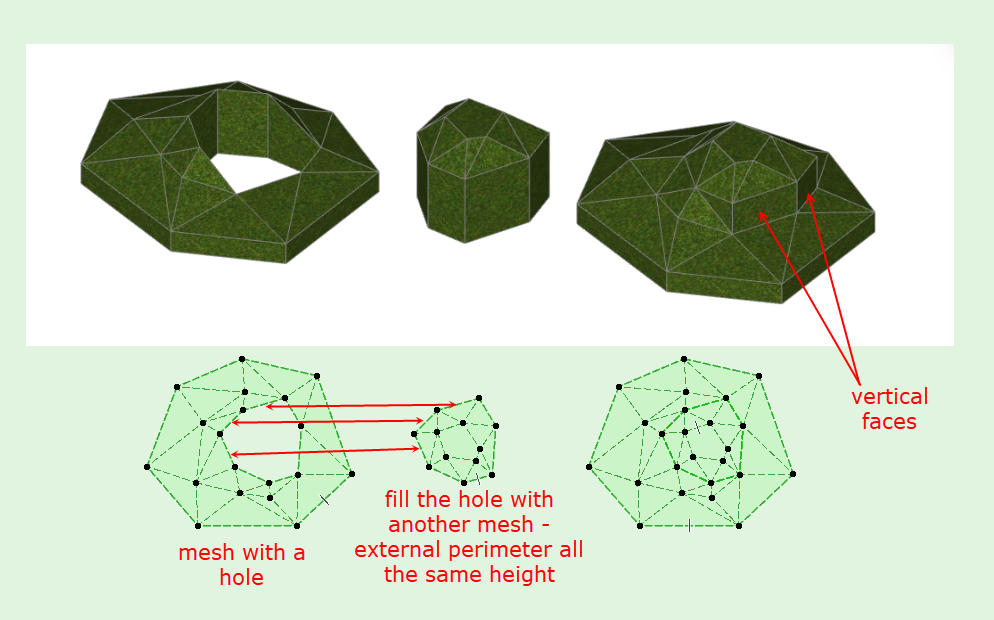

I had a little think about this.
Why not just use 2 meshes.
The edges (or skirt) of the mesh is always vertical.
Create the main mesh with the contours and set their heights.
On the contour where you want the vertical face, cut a hole.
On the edges of that hole on the faces you want to be vertical, ensure the node heights are at the lower contour level.
Now add a new mesh and elevate the perimeter heights to the upper contour level.
Add more contours on top of this if you need.
Repeat if you happen to have more vertical surfaces.

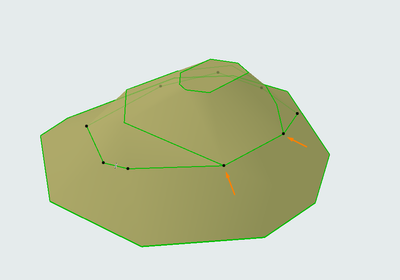

The software now can create only the A option:
david_skogvold
True, only option A can be done using a mesh. I agree this is not ideal, and would also like a more advanced mesh tool, but I think you may be trying to make a simple tool (terrain mesh) do something it's not meant for.
It would be easier to suggest a workflow if you showed an example of the data you want to import, I am thinking you could use the morph tool as a kind of advanced mesh and keep much of the editability, but the initial generation of it may involve a bit more manual work than just importing your 3D contours and automatically generating a mesh from them.
