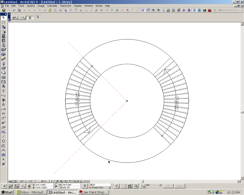

Hi, folks, can someone help me make some curved stairs? I'm getting close, but not close enough.
I've got a 30' circular atrium that goes through four floors of the building, and I want a curved stair that ascends less than half the perimeter, and outside its outer edge, requring walking to the next flight, so that each floor's stair is a mirror image of the one below, but so that they don't meet in plan. In other words, each flight will be less than 180 degrees. I'm still playing with the design, so I don't know by how much exactly.
I've been messing around with the angle in Stairmaker, and I'm getting close, but I just can't get the stair to align with the edge of the opening in the slab. I've tried doing it with Stairbuilder, too, but something about the settings I'm using is crashing that and not producing any stairway. Or was it Stairbuilder that allows setting the angle? I can't remember. Either way, it's not working very well.
I'm afraid I really don't know very much at all about stair design in the first place, and coupled with the cryptic selections in Stairbuilder in particular, I'm at a bit of a loss for an easier way to do this - and to ensure proper cuts out of the slab or additions to it, or whatever is needed in a situation like this.
TIA for any assistance.
Wendy

Use the "Create Stair Using Selection" tool. See "Creating Custom Stairs from Drawing Elements" in the Help menu.
Like this ?

Can you post some pictures of what you are trying to do?
If my Internet connection will keep connected - it's been a real problem this evening <sigh>. Please ignore the rest of the mess on the screenshot.
Your second diagram is the basic plan, but with the two stairs on separate stories, and with the inner circle actually a hole in the slab.
Wendy
Something like this?
in 3d it looks like this.
Steve,
Yes, exactly, except with the stairs on only two sides, so that one has to walk between the flights, and facing the other direction. I suspect the atrium is going to shrink, though, because I'm already having a hard time fitting everything else in around it.
Is it possible to extend at least some of the treads so that they are deep enough to require a couple of steps, or potentially even incorporate a short landing or two part way up, so that the progression from one floor to the next is lengthened and slowed?
