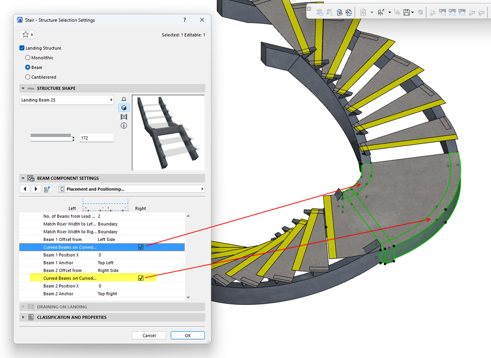

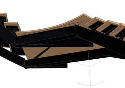

Hi all,
Anyone know how to get landing beams to curve? Or am I going to have to morph it to get it to curve and connect to the flight beams... The plate is a whole different issue...
Ling.
Operating system used: Windows W11 24H2
Setup info provided by author
2 Replies 2
Does this help?
Lingwisyer
Guru
Ah, the Custom placement option does not have that option. Unsure why it was even using that option... Explains why this is the first time I've run into this.
