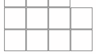

Is there any way to have custom 2D (floorplan) for a Curtain Wall panel when the Curtain Wall has a inclination of 0° ? (meaning the CW is lying flat down, not standing upright)
The "Projected with symbolic Panels" doesn't cut it, imho.
I know, I could possibly make a 3D doc, but thats cumbersome, as we all know.

Custom Panels with different geometry.
The CW tool can be abused quite nicely, but the 2D will always lack a bit.
Holes inside a panel will be projected nicely, yes, but nothing else. That's why it would be nice if we could generate some more lines. Or script them.

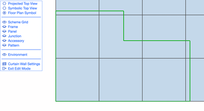

There is another way to get a curtain wall object to be on the horizontal plane.  You simply create it in a plan view with the poly line creation option in the toolbar.  It's the button on the right in the image below:
That may give you a different plan representation than if you create it vertical and turn it on it's side. Once you've created it you can modify the Boundary poly line by clicking the edit button on screen when the curtain wall is selected.  Hide all the sub-elements except the Scheme Grid...it makes it easier to modify.

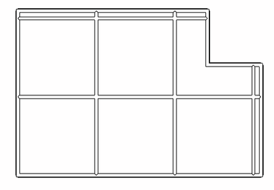

Below are 2 different quick schemes to show how it might look.  The first one uses invisible gaps for frames with custom panels created using a morph.
The second one uses more typical frame and infill panel types.
Is this what' you're looking for?
