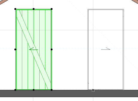

I have drawn a custom door leaf in plan view using slabs. and then saved this as a door leaf by going file -> Libraries and Objects -> Save Selection as -> Door Leaf. I have then change some of my door leafs to this new one. in 3d view i can see that its changed, but in elevation view i want to be able to see the decorative lines on the door. How do I get this to show up in elevation view?
Attached a picture to show what I mean. Both of these doors have the same door leaf. When I highlight it I can see the lines on the door. But the door on the right is how it displays on elevation view.
8 REPLIES 8
It seems that you need to have a gap between slabs when drawing the custom door leaf for the decorative lines to show up in elevation view. Is this the only way?
You could also have a copy of the surface material on alternate boards on your door. If surfaces are the same they will heal at joints, removing lines between. If the surfaces are different (they can have the exact same properties as long as the name is different) you will see the lines between each in elevation.
Aahh ok - so all my surface materials are the same. so if i was to alternate them maybe? it would show the lines. I will try that now!
Oh my god thankyou! that worked! thats a handy tip to know!!

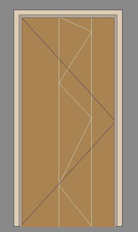

Hi, even though the method s2art explained is the best way to do this, I just want to add that you can also draw 3d lines with the morph tool in the face of the door leaf, but you have to do it on both sides in order to see them in both sides of the door.
This is just a little trick that is good to know (see the white lines in the door, those are with the morph lines that are only visible on this side of the door, because I didn't draw them on the other side).
