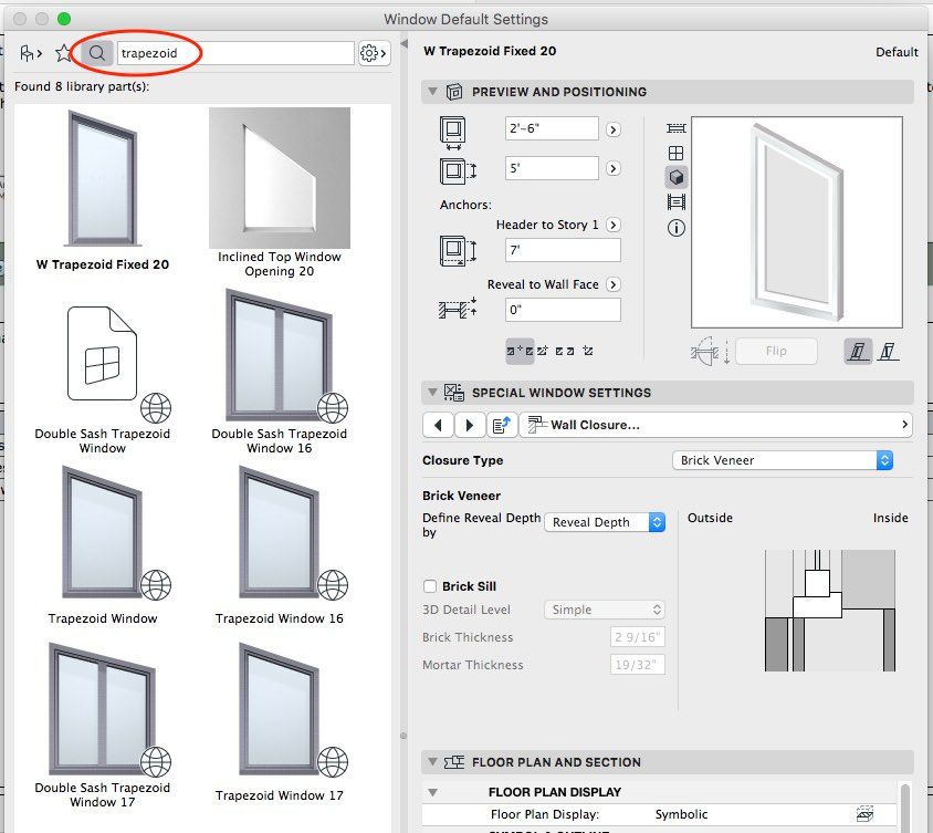

Can see the trapezoid now.😉 If it is really a trapezoid you need, there is a standard trapezoid window. Search for it in the windows setting dialog to download if not in your AUS library. The advantage of standard parts of course is that they provide all kinds of parametric behavior, particularly wall closure options.

Thanks again Karl, trapezoid window was in my library. Not sure how I missed that one
. Anyhow, the information you provided will be useful for future reference.
