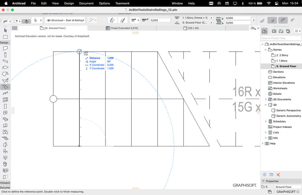

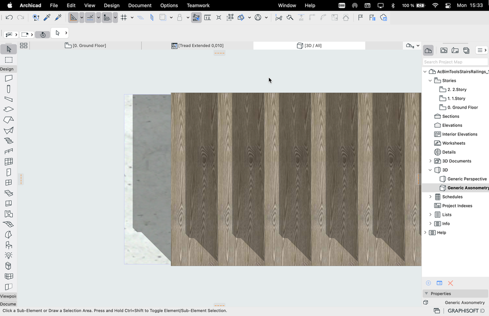

Hello,
I have a similar problem:
  • Custom treads a bit wider than the stair structure
  • Made via Edit Mode scaling > Morph conversion > GDL tread
  • In the Floor plan they are as wide as the stair structure
  • In 3D they are wider than the stair structure
Although I understand your solution, this doesn't help because then the 3D view is wrong.
Best regards, Horst
