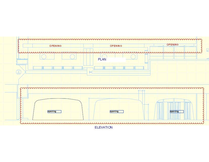

I need help on how to get this profile onto the wall.
I trace the profile on the elevation, used the slab tool and magic wand the outline to get the shape. Now, what's next ? How do I get it to the wall with this shape [made from slab] with the SEO tool ?
Help

You could do this and use Solid Element Operations to cut the shapes you want.
http://www.archicadwiki.com/ModifyTheSideContourOfTheWall
Or if it just the openings you want you can create a custom window.
http://www.archicadwiki.com/CustomShapeDoorWindow
Llian
Thanks...I did it!
