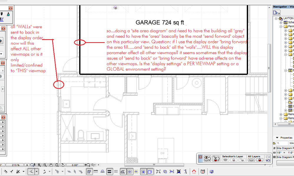

see attached.

I don't know for sure, as I haven't researched this, but I assume that if, for example, you bring a wall in front of a slab in any plan view that wall will be in front of the slab in all plan views that have those elements visible. You can, however, change the display order of elements in elevation or section views and this does not effect the plan display order.
IF you have placed a fill over your building to indicate its outline on your Site Plan, and bring that fill to the front, you should not then have to send your walls to the back as well. This would effect the wall's display order relative to other elements you will see in different layer combo's / views.

Well you'd think if I insert a fill with a visible edge line, and bring that fill to FRONT, you'd think that any other objects would be BEHIND the fill and its edge line BUT that is NOT always the case. It seems that when I select the FILL, the program responds with "cannot bring any further to front".......yet sometimes there's STUFF in front of that fill.....dunno.

Also, in certain views I want....no...NEED the fill to be IN THE FRONT and in other views I may need ALL WALLS to be in front, so I ask ARE DISPLAY ORDERS OF OBJECTS , WALLS, FILKS, SLABS, ETC controlled per VIEWMAP or controlled globally PLAN only in referring to here. I know on elevation and section you can bring certain objects to front but what about in different PLAN view maps?

Then maybe you should save multiple Views showing different Layer Combinations and arrange those Views on a Layout to obtain the result you want on the Layout.
By the way, some confusion about terms there...
There is a single View Map, which can contain any number of Views.

well...I thought that would do it...but it appears that when I save the view, then place on the layout, I notice that the "display order" is not right. In one view, the "walls" should up correct, then when I go to the view that I need to fill to be on top, governing how the "view" settings are...the walls revert back to being on top. Then I set the walls back to "send to back" on that specific view. All is fine, until I got to the view where the area fills need to be "send to back" and the area fills are on top.....again....it's ver strange. it's as though the "display order" wont adhere to the viewmap settings.

see pp. 635 ff for the description of the default stacking order in The ArchiCAD Reference Guide PDF from the Help Menu. This might shed some light on the default behaviours and what you have to do to subvert it.

HERE'S WHAT I'M GETTING.

You have reached the top of the stack and you can't bring the fill any further in front.
When all elements are at the top of the stack (or at an equal level in the stack) I believe they then display in there default order i.e. fills behind other elements.
So you now need to send the column and cabinets back.
However as far as I know there is no way of saving the display order differently in different views.
What you see on screen is what you will see in all views.
The only (painful) way I can think to do it would be to have the same fill in two different layers.
One set behind and turned on when needed and the other layer off.
The other fill in the second layer set to the front and turned on when you need that and turning off the layer with the fill that is set behind.

I think the key is Rob needs to select the columns and "send backward" one step, not "send to back" to have them behind the fill, but not behind other elements.
