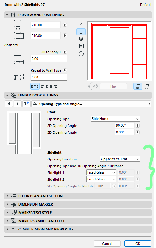

Hi everyone. I need help on this. I wanted to make the sidelights as part of the door and to be reflected on door schedule but I need to retain its action as Pivot. Thank you for the assistance if anyone can.

You can use a default library part to have a door with two openable sidelights (this is a screenshot from AC27 but I'm sure there's and equivalent in AC28):
This will show up in the schedule as one unit.
Or, as an alternative, you could individually model this with a curtain wall and make that part of your overall schedule.
