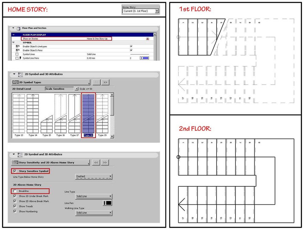

Matthew wrote:any kind of stair, exactly, its just a parameter setting, but where?
What kind of stair? If available it should just be a parameter setting.
2010-04-19 08:30 PM
WENDY_NEVERLAND wrote:I mean is it StairMaker, Archistair, library parts, etc?Matthew wrote:any kind of stair, exactly, its just a parameter setting, but where?
2010-04-20 07:10 AM
2010-04-20 08:17 AM
Matthew wrote:Stairmaker I have and I dont like itWENDY_NEVERLAND wrote:I mean is it StairMaker, Archistair, library parts, etc?Matthew wrote:any kind of stair, exactly, its just a parameter setting, but where?
2010-04-20 08:23 AM
sigitas wrote:if I uncheck the breakline the other two options disappear
If you would like to see stairs in dash lines above break in first level
choose the 2d symbol type 9 or type 11 form stair selection settings.
whole stair in 2nd floor in settings from 2d above home story select show 2d under break mark and show 2d above break mark and uncheck the breakline.
2010-04-20 01:42 PM
WENDY_NEVERLAND wrote:Hi Wendy,
I just want to see dash lines above break in 1st floor and then the whole stair in 2nd floor!
