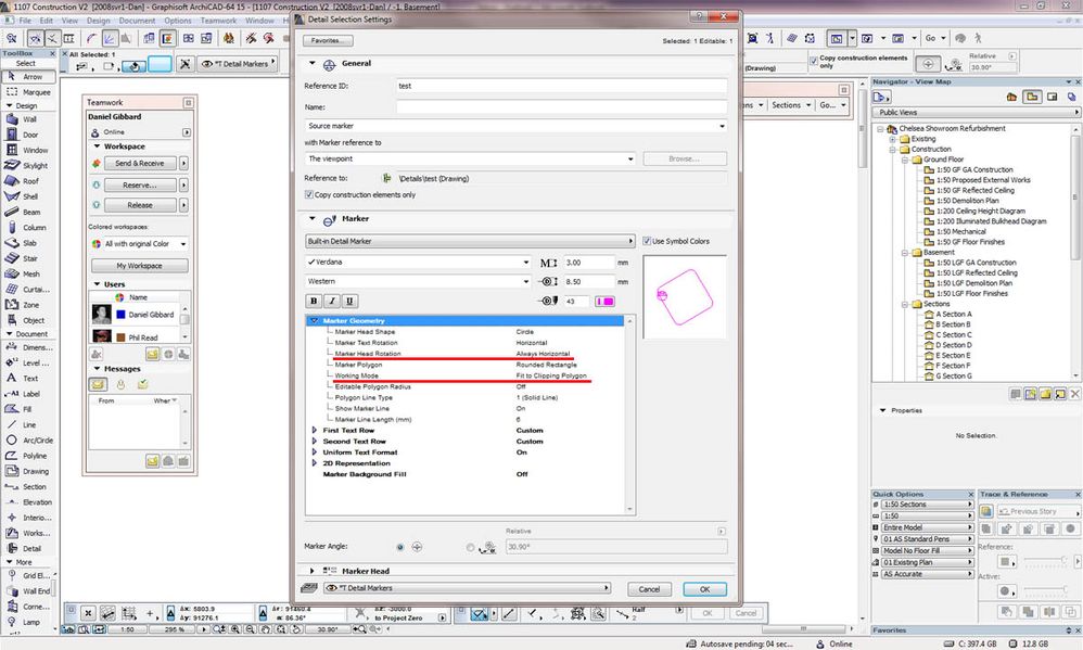

I have a viewset where my project orientation has been changed to 270degrees. When I place a detail marker to begin with the text is relative to 0degrees still (the wrong way round). I can change the orientation of the detail marker manually by changing detail marker settings, however the marker (that shows on a print) then sits in a completely different place to the source marker (which doesn't show in a print), why? See attached.

I was able to reproduce your bug by placing a detail marker (Built-in Detail Marker) and changing the Marker Rotation Angle in an Oriented View. But if I place the Marker, leave the Rotation Angle as is, then open the Marker's settings and go to Marker > Marker Geometry > Marker Text Rotation > and set it to Vertical, all is fine. What are the exact steps you took?

David,
I have figured out what my personal problem was, it was me! I have just been having a fiddle this afternoon and discovered I just didn't have the right combination of settings to get what I wanted. Having marker settings as per attached (and underlined in red) solved my issue.
The bug, if it is a bug, occurred after doing exactly as you did.
