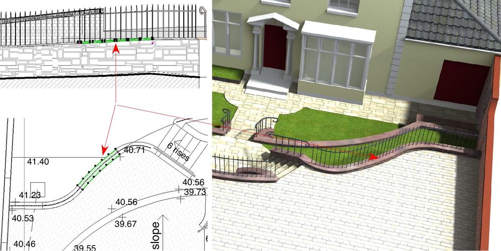

Take a look at OBJECTiVE - it provides tools to create profiles and bend the to curves in both plan and elevation, which is perfect for shaping kerbs to sloping & winding edges. If you refer to the attached example, I have selected one object (out of many) created and shaped with OBJECTIVE that does exactly this (and also acts as an SEO operator for the wall below).
For more info, point your browser to: http://www.encina.co.uk/objective.html

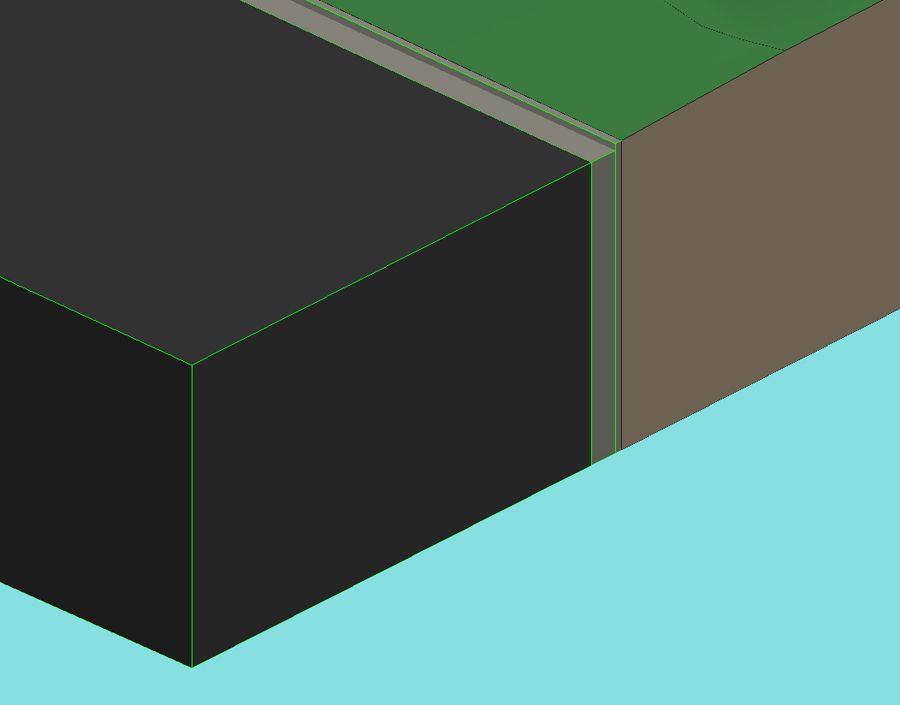

HI Dave,
The way you described your use of mesh tool sounds interesting to me.
Would you mind posting a 3d image of what you described?
It would be much appreciated.
Thanks
Bier
Hi guys,
Here's a very basic example per Bier's request.
All the entities are meshes. The black part is the street.. In this case, I've modeled it to the centerline. The corner at the lower left is a hair higher than the corner that touches the gutter. The grey parts are the gutter and curb meshes. The part that's tan on the sides and green on top is the earth. I set all the meshes with a consistent reference plane on the site story, such that I've got a meter or two of thickness at the site's lowest point. The top surfaces of all these meshes can be edited at will, of course.
Here's another trick I use for flatwork (paving) on significant slopes.. I model the paving as a mesh, put in all the slopes, edge elevations, drain inlet low points, etc. then copy it. Lower the copy a few inches, subtract the copy from the original using a solid element operation, then put copy on a 'scratch' layer that stays turned off all the time (unless I want to see it). Similar idea to what's shown here, but with the mesh's lower portion cut away to turn the top surface of the mesh into a 'warped plate' with thickness of my choosing (difference in elevation of the two mesh entities used).
My site modeling method is sort of like making a base for a physical model. As a matter of fact, that's how I approach Archicad... I'm making a very detailed physical model in the traditional sense. Now if I only had a rapid prototyping machine......!!
Hope that helps
Warm regards
