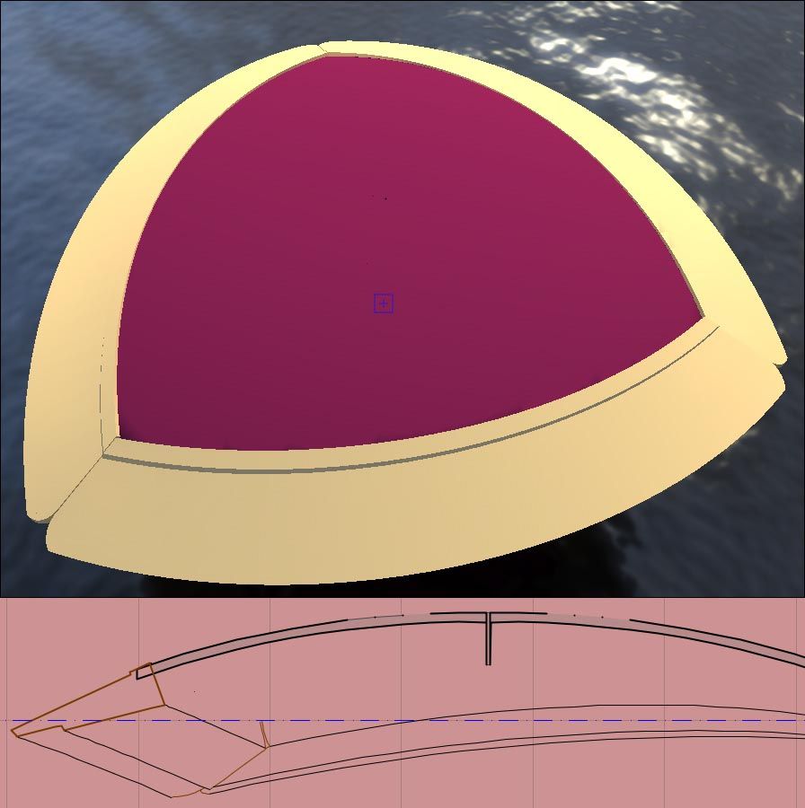

Parametric elements rarely start with drawn shapes as you have done.
For instance, your curved beam-made-from-a-slab is not extruded along its length, but from the top down, making a series of nodes approximating a curve along each face.
This data has no "intelligence," since it isn't related to the parameters we use to control beams.
A curved beam would be made in GDL by describing the section and then applying a SWEEP [described by a radius and arc length] or TUBE [described by lateral path nodes] command.
Today, the best bet for curved things that change elevation is the wonderful OBJECTIVE Add-On. The attached shows an arcing sweep made from a complicated section shape via OBJECTIVE. Yay, Ralph!!
