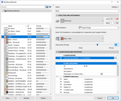

when you draw modeling elements, they have building materials
building materials have intersection priorities.
higher priority material cuts lower priority materials.
layers have intersection group numbers
if an Element is on a layer, the intersection priorities are used to automatically work out what cuts what.
if an Element is on a layer with the same group number (even if the layer is hidden), the intersection priorities are used to automatically work out what cuts what, hence the holes in the brick with the layer turned off.

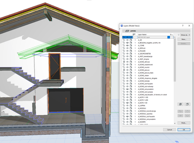

an you explain a bit more in detail? Are you referring to the group number that is represented with the number 999 or number 1? Why do all the numbers except the hidden layer have the value 1? Is this the default value? And what is the effect of changing the value to 999 on the layer "Hidden"?
Every layer has a group intersection number.
That number is stored in each layer combination, so it can be different for the same layer in each combination.
The number can range from 0 to 999.
If it is zero, then nothing in that layer will automatically trim - i.e. walls will not trim with other walls or beams, slabs and walls will not automatically trim.
If layers have the same number as each other, then elements in those different layers will automatically trim to each other (see image for Basic Intersection Principals below).
If layers have different numbers (not zero), then elements within the same layer will trim, but will not trim with elements in different layers that do not have the same number.
You can still force a trim with a Solid Element Operation.
Automatic element trimming is based on this which you can find in the reference guide...
Allan, thank you for your additional explanation and the table. I understand better however I still have some issues.
The building that I'm currently working on has 2 roofs: One above the 2nd floor and the other above the 1st floor. The sidewall above this lower roof has a different composite than the internal wall below the roof on the same position (construction wise is the same wall). So I went to model the two walls and I trimmed both with with the roof. This went well for each of the two walls but when I finished the 2 trimming operations and turned back on all the layers, there is a hole at the intersection region of the previous two operations. Its like my "manual" substract SEOs worked fine but then combined made a third automatic substraction.
Based on your 1st anwser Ive now changed the number of the layer to which the lower wall belongs to and the hole dissapears. Cool, thank you.
All looks good in section and other 2D views also, thanks again!
