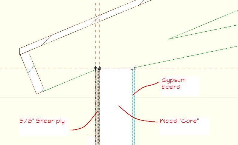

I am "switching" over to using more Composite walls. I have set my Wood framing as the core in most cases. Dimensioning is a bit more tedious, but I am getting better.
In a Section view of a Composite wall the Default "live" pick points on the wall are the Outer skin no mater the "Core" settings. Is there a easy way to dimension to the core of composite walls (or floor, or roofs) in the Section window?

Well, I was not taught, so that is my main "problem". I am engineer and while what we call the "pretty" pictures are important, and AC does a great job creating them, it is the Structural drawings that are of upmost importance. Dimensioning to anything other than the Core of a Composite or the outside of a 5.5" non-composite (single fill) wall would be bad form and truss manufacturer for one would not be happy (first of a line of unhappy people).

Ummm... what part of snapping to composite skins in section doesn't work for you guys? The mercedes cursor is indeed a snap...and appears anywhere along any skin.
Being "live" (associative) and with the possibility for 'core only' as Jay desires is different matter from snapping...
Karl
Yes it is a "live" dimension node (the circle symbol, right), but also if not zoomed in close the "default" dimension snap selection honestly seems to be hit-or-miss in regards to the core. I would like to, of course, see it "live" to the core (think the Live dimension node only shows at the top an bottom to the wall at the outer skins), but I would like at least the default (non-zoomed in) dimension node be to the core.

Jay:
Do you off set the walls reference line?
If so, you should be able to dimension ("Live" - circle symbol) to the reference line... as well as the outer skin. BUT, you'll only find theRef line node at the bottom of the wall.
