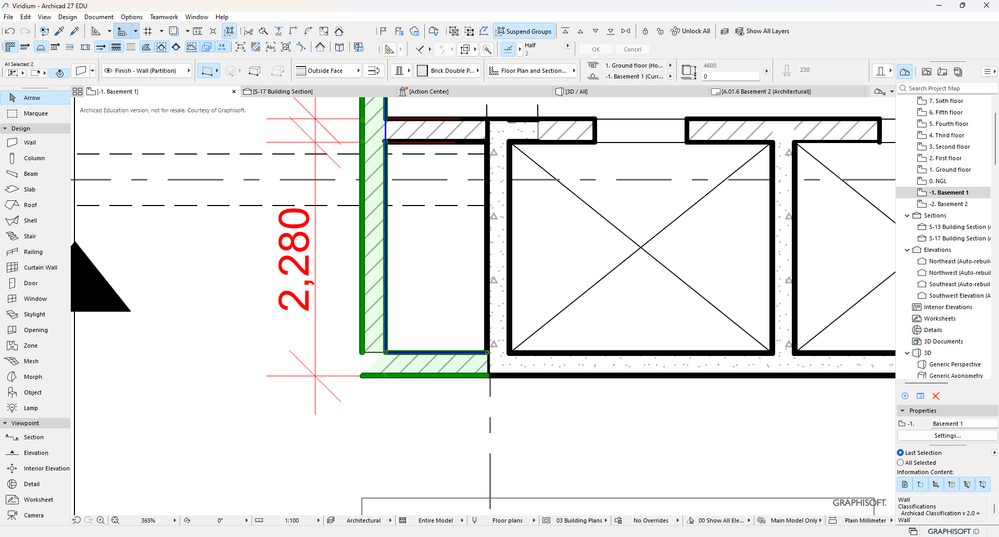

Composite wall ends and corners not showing proper line weights!!!
Abdullah Chaus

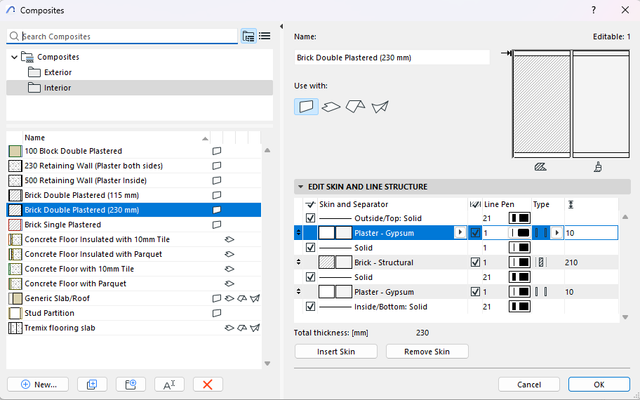

The end lines of my composite wall section at corners and ends do not have proper line weights. I have tried searching all over the internet and everybody says to make the composite section's pens equal. Well, I did that but it's still not working. Please see the attached screenshot. Also, I have 'Both' options turned on for wall end in the wall settings dialog :}

Judging by the angle on the corner, the wall is interacting and trimming with another wall in a hidden layer.

In you wall composite settings, each skin has an option to show the end lines.
Try turning those on.
I already tried that but no luck 😞
Are the walls connected with non visible walls/uncut walls? 

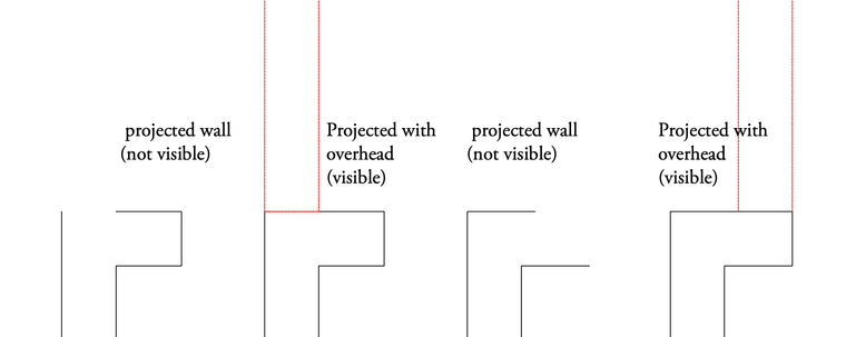

Set the floor plan display to projected with overhead.

There were some hidden elements. And I deleted them but only part of the wall end turned into the proper lineweight. One end is still problematic. And I set the Floor Plan view to 'Projected with Overhead' but nothing happened...

Yep, that was it. It was a beam, not a wall, though. Thanks a lot
