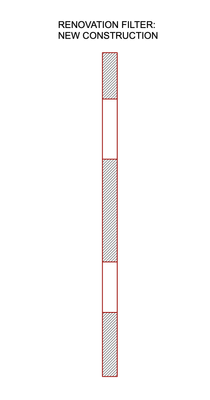

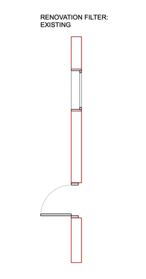

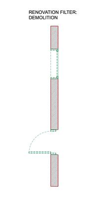

Hi all, I am running into a display issue in 3D window when using the renovation filter for demolished doors windows on an existing wall.
I have a door and a window need to be demolished on an existing, so I use the renovation filter to assign them to be demolished. You can see below  they all work well on the plan.
N3N4_0-1711749899477.pngN3N4_1-1711749911282.pngN3N4_3-1711749930484.pngN3N4_4-1711749951363.png

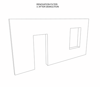

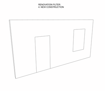

However, when I switch to the 3D window, I don't know why there are still silhouettes of those demolished door and window shown on the wall (the last image below: 4. New Construction.) I have check everywhere to change the 3D display setting but still can't figure it out. Hope anyone can share their experiences or work around to fix this issue. I bet there must be some setting I missed somewhere. Many Thanks!

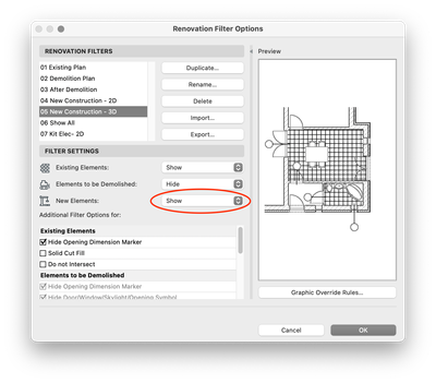

For the 3D view, set the New Elements in the Renovation Filter Options to Show, not Override.
David
