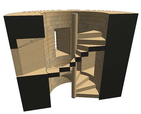

Dwight wrote:Thank you, that works well for the 3D view (if I hide the layer with the operator element), but then the wall looks solid in the 2D view -- which makes this method a bit awkward, I think, when the building becomes more complex.
A one step method would be to use a slab block placed behind to SEO the wall.

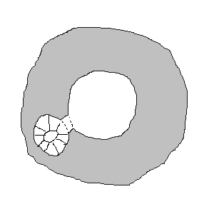

manfredkooistra wrote:No, spiral stairs are the easy part!
...Because the difficult part will be, when I try to model a spiral staircase inside the circular wall

Peter wrote:I have not expressed myself well: I don't want the spiral stair in the empty space enclosed by the circular wall, but inside the body of the wall itself.manfredkooistra wrote:No, spiral stairs are the easy part!

‎2008-03-01 09:52 AM
Dwight wrote:
And you just won't drop a cylindrical SEO down through the wall?
