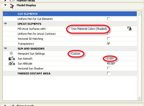

I'm trying to work out all the bits and pieces of ArchiCAD to try and convice the boss to switch over to it from VectorWorks. However I've hit another snag with the elevation/section tool.
When the 'shade with own material colour' is selected the elevation, the elevation becomes nice and pretty as desired. However all of the material colours are extremely dull and completely off from what they look like in Element Attributes - Materials window. And when the sun shadow is turned on it gets even worse.
For example, a material with surface and emission colour set to pure white, and ambient and diffuse set to 100%, looks pure white all over in the Materials window. However, in a section or elevation it comes out as a mid to light grey.
How can I get these materials to come out brighter and more like the colour I set them?

Thanks for all of the replies, however as we are small business, 2 people, buying another program isn't really a good option, and I'm not too sure how to get the elevations from the 3D window.
I did find a solution tho, which was staring me right in the face the whole time... why does that always happen. Instead of selecting 'use material colour - shaded' I needed to select 'use material colour - non shaded'.

It's quite easy really:
The Shaded method will use the Sun's settings to determine the shade (brightness/dullness) of the materials in the Elevation.
The Non-Shaded method will use the exact colors as per the Material's Surface Color, disregarding any sun settings.
Having said that you can use the Shaded method with a Sun Azimuth of 0 degrees to make the colors appear at full strength too.

Mats_Knutsson
Is this what you're looking for?
Fill uncut surfaces with own material color non shaded AND select custom shadow (doesn't work with shadow generated with system sun).

A hybrid option is to use the material colors-non shaded, but turn the elevation shadows transparent.
