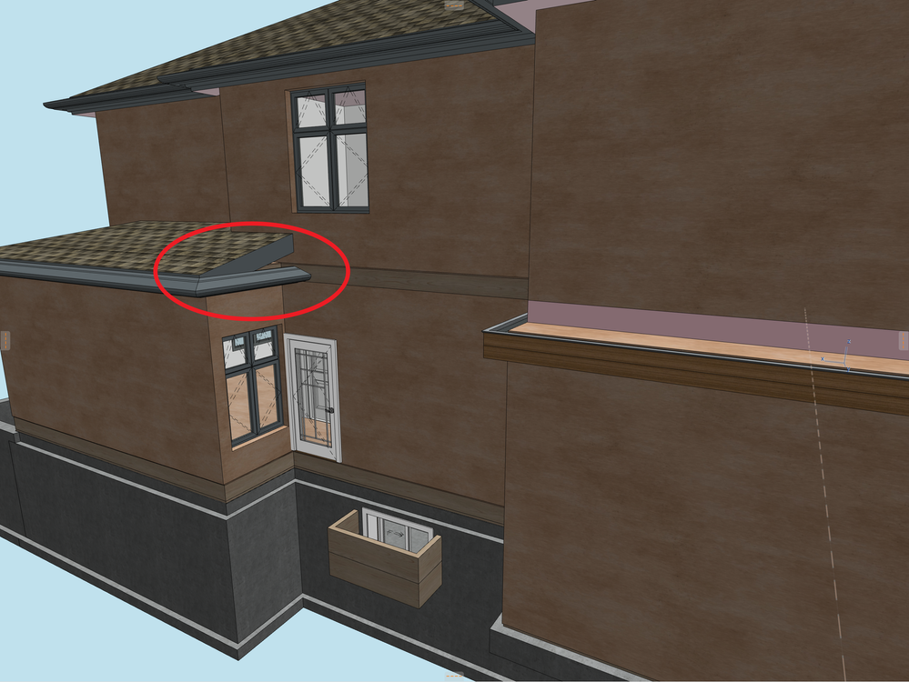

Eave attached to side edge of sloping roofs

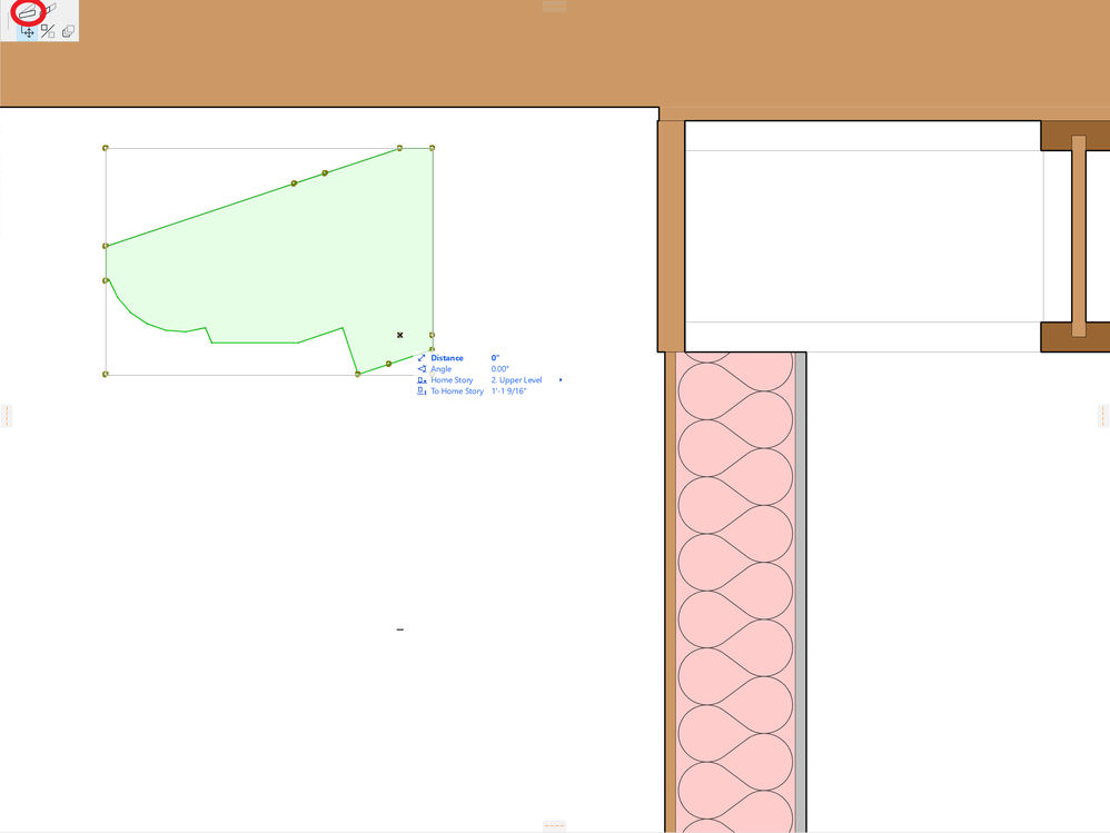

Hi, I created eave for a side edge of sloping roofs as showed in 1st picture, the problem showed in red circle, so I made a section to change angle of eave up to 15° as same as roof pitch as showed in 2nd picture. Then the eave and roof edge was aligned, however new issue appeared as showed in red circle mark in 3rd picture, how shall I do to solve it

It is all about the transitions.
The same shape profile can not mitre at a corner if they are different pitches.
You need to transition flat around the corner and then transition from flat to rake.

As any craftsman/carpenter/tinsmith can tell you - that is never going to work perfectly in the model, or in a real-world application.  It's like trying to merge a round tube with a square tube.  It will require some elements in the transition that are not something anyone wants to build/modify for the situation shown.

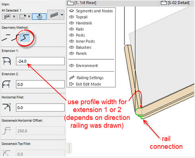

It is using the railing tool to wrap a profile around the roof edges.
But you can see in the second image  (this one)
that the horizontal profile has to wrap horizontally around the corner (to for the 45° corner mitre) and then that small return then mitres with the profile raking up the roof.
So basically there is a 2 stage mitre rather than a single one where you are trying to transition around the corner and up the slope at the same time.
