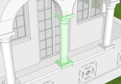

I think I'll give it a try on the Library Part Maker. It's more intuitive for me to keep building parts embeded on that model. I have some buildings in my project as Hotlink Modules. That works but the workflow is more complex. All I wanted was sometthing like an autocad block or a sketchup component. Easy to update single replicable object.
An image of the column in question.
I want to keep editing the column after but not very often.
Thanks!
That column is very easy to create using a segmented column (version 23+).
