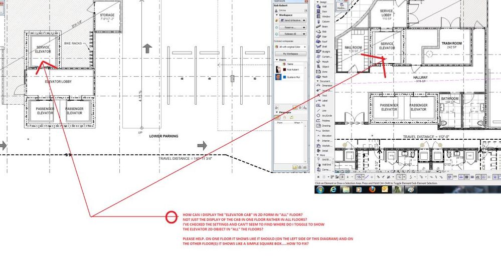

how best to display the 2D (the one that shows the doors) of the elevator cab in ALL the floors?
I can show the elevator cab with it's doors in ONLY ONE FLOOR (the home story of where the elevator object got placed) but I can't seem to show the elevator cab with the doors in "ALL STORIES"?
How to correct this?

I failed to find a way of doing it, had to place 2D symbol manually.
rob2218
....2D symbol manually. That's exactly what I had to do. I created a 5'X5' standard/generic elevator cab graphics. Selected them all and created a new 'embedded object' and called it "Elevator_Cab_2D.GSM" and be done with it. It's a simple 2D dumb object but so be it.
