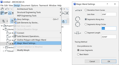

Walls don't do ellipses, but they do arcs. The closest you will get is to draw your reference ellipse, select the wall tool and then Magic Wand the reference. The result will be an approximate ellipse made up of arcs.
Steve Jepson
Draw ellipse - Select Wall - hold down the Space Bar ( magic wand) - click on the Ellipse.
https://www.youtube.com/watch?v=Z_DghcEjWSY
The number of wall segments you get is determined by your magic wand settings.
Thank you to DGSketcher and Steve Jepson. your solution worked perfectly. Another lesson learned by me. Again, thanks for the help.

Walls do not have an "elliptic" Geometry Method. However, the Arc/Circle tool lets you draw an Ellipse, which you can then SPACE-click to create the Wall geometry. But since Walls can not be elliptic, the best Archicad can do is approximate the ellipse with curved Wall segments.
