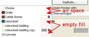

Also, if a material has Empty Fill assigned in (IE) vectorial hatching it will actually have a fill, whereas Air Space has no fill whatsoever. See attached.
