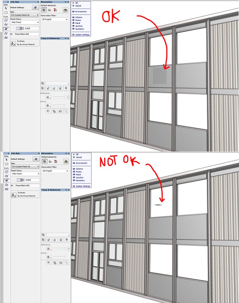

Option (or alt) -click some other panel to copy it's attributes. After that, you just need to select the panel tool from toolbar, and click the empty hole. You don't keep any keys down this time (oddly enough) as you do other times in ArchiCAD when forcing attributes to other elements, like transforming visible panels to other types of panels. There is a visual clue, a rectangle, when you are to click it. See attached pic.
AC28, Rhino8+Grasshopper, TwinMotionMac Pro 6,1 E5-1650v2-3,5GHz/128GB/eGPU:6800XT/11.6.5 • HP Z4/Xeon W-2195/256GB/RTX4080FE 16GB/W11ProWS
Thank you for your answer. Unfortunately it doesn't work since the empty hole is not identified as a panel. The rectangle gets lost in space, as you can see in the attachement...
mikas
I can see a bigger rectangle in the empty panel, which is the size of the panel. I do not refer to that little gray rectangle, which seems to be the indicator for 3D-plane orientation. You should notice a see-through rectangle. You can see the rectangle in my pic. Then you should be able to just click the hole with panel tool selected. And again, NO keys pressed at the keyboard, or it won't work.
It seems that you do it all right, but still, I can't see the "hollow", panel size rectangle, in your attached picture.
If that doesn't do it, then I've got no more tips, sorry.

  • an empty panel (the panel was deleted). In this case, there's actually nothing there that you could select, it is empty. If you want a panel there, you just have to select the panel tool from the toolbar, and click into that empty space to insert a new panel.
