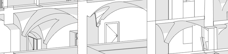

@Paul King The basic truth: Archicad (especially library objects) can NOT deal with vaults, wobbly arches, uneven floors etc. Even having antique windows in trapezoidal prismatic walls is a nightmare. In 3D it will look fine utilizing Morphs and mesh tool, but plans, schedules, renovation status ... Try to have a correct floorplan depiction with new windows in existing complex window flanning ... Archicad was never intended to deal with that - and it can't.
Mesh-surfaces derived from a point cloud are useless - suitable abstraction is the name of the game.
In order to utilize Archicad’s (limited) functionality something like PointCap would be appropriate: Generate and position 2D polyline-slices from which an Archicad model can be created according to arbitrary output necessities.
