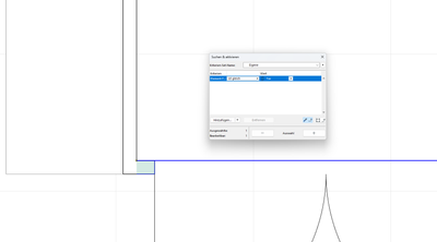

Does anyone know how to search and choose all doors that are in specific wall type?
I am not sure which criteria should I set in the Search button?
Thank you!!

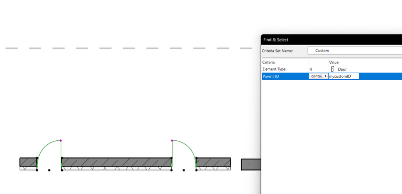

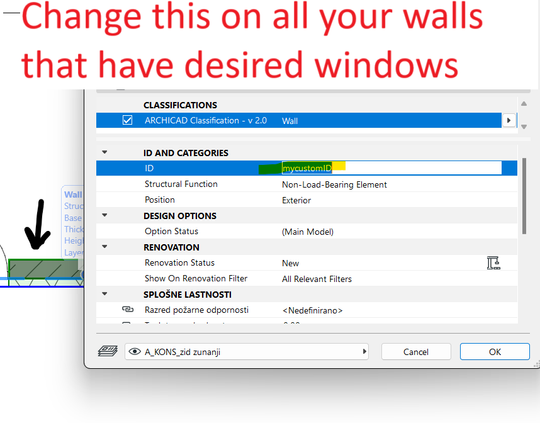

@ananas
Hey there! 😊 You can try changing the Wall's ID from its default to something custom. Once you've done that, head over to the Find window, select "Parent ID," and type in your custom value. Just a heads up, though—you'll need to manually update the ID for each wall where you want the windows to be selected. Hope this helps!
