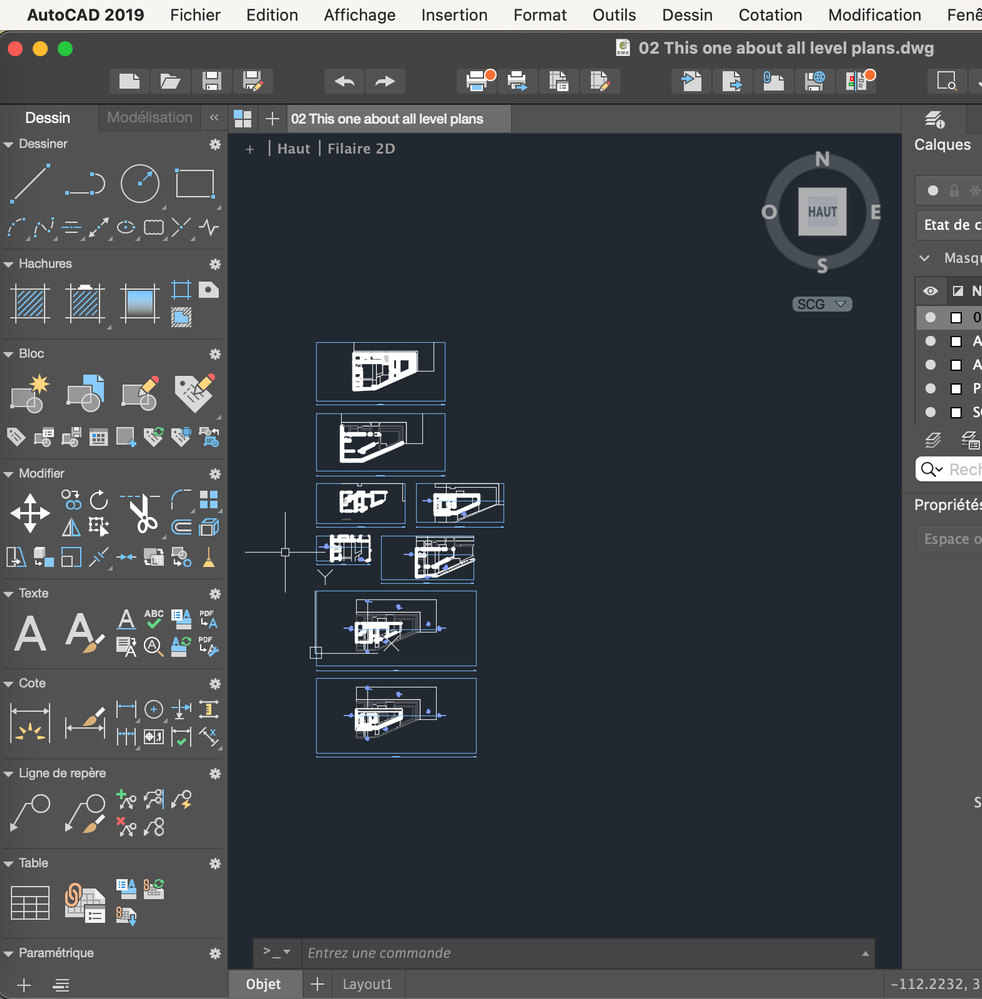

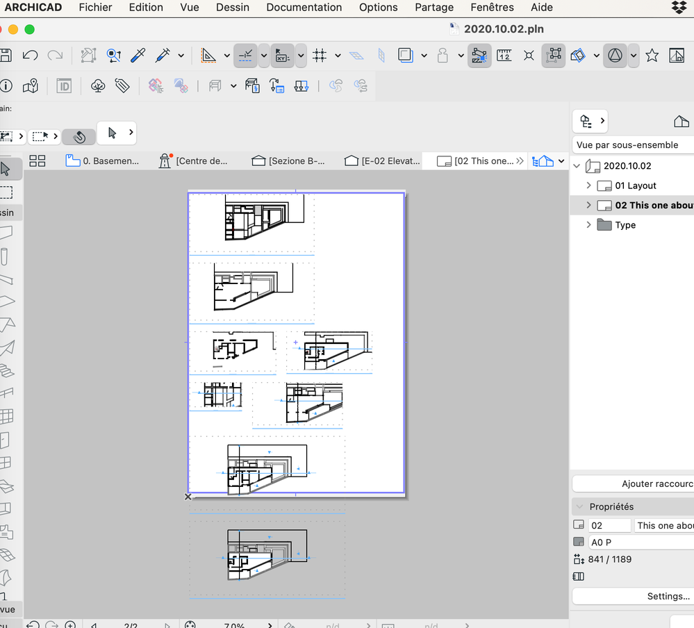

Into AC you should put all your level plan views into one layout
Then add this DWG export translators into Archicad before publishing DWG :
https://fromsmash.com/all-dwg-into-one
It seems to be like this :
All your level plan views into Autocad "Object" space through one publication.
Is it what you need ?
