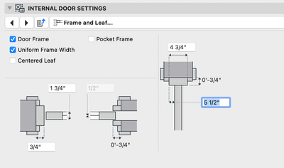

Exterior sliding door offset from the wall disabled
enjoystick1
is there any reason for the exterior sliding door having greyed out the option for offset towards the wall? Am I missing something or is this really not possible?

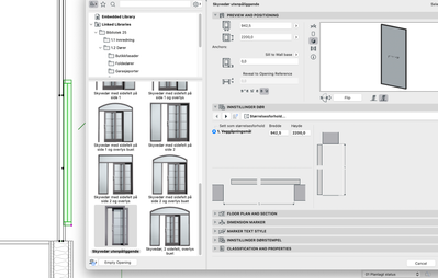

it appears that door does not have a leaf position or even frame position option. As an alternative, you could try the pocket door with the leaf position set to push the door outside the wall the desired distance
yeo, that sounds like a workaround here, thanks!
