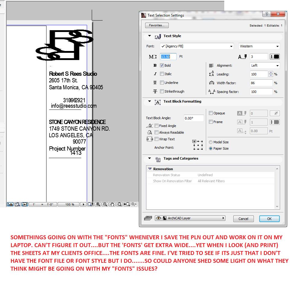

something's happening with my "fonts" whenever I saveas a PLN file thats in my clients office PC to my laptop (also a PC). The fonts on the Master Title layouts seems to be stretched or out of proportion in the horizontal direction.
see attached.
Has anyone had any strange experiences like this and if so, how did you fix it?

Check the Windows Custom DPI settings. (Under Control Panel > Display). I don't recall if they need to be set for 100%, or just have to match each other, but probably the issue is there.

ok....so I tried to alter the settings in that dialogue box in the DPI settings....to no avail.
I'm going to try to alter in this setting in the control panel>display>DPI the percentage. see if that does anything but other than that....there was no effect.

So noticed something...on the PC at work, this particular check box is greyed out. On my laptop...it's a usable checkbox parameter....

From your screenshot there are brackets around the font name [Agency FB]. This means that the font is missing from your computer and ArchiCAD is substituting a font in its place. Install the font from the same source on both computers and it should resolve your issue. Please let me know if it does not.

did not know that [] around a font meant that it was missing....I'll do that right now sir!

rob2218
Nick!
you D MAN!
..........thank you thank you thank you so much sir!!!!!!
