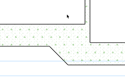

1. subtract
I thought no.
2. I have to move to the same point with two slabs to be combined.
3. Is this normal?
Or am I doing something wrong?
I would like to know the exact way to combine.
What is this phenomenon?

If your slabs are the same building material then apply a Subtraction SEO and they should then merge e.g. subtract the upper slab from the lower one.
This may help... Basic Intersection Principles

I did not combine even after SEO, so I had to move to the same coordinates to be combined.
Is moving to the same coordinates a function?

Not really a function but it may have forced a redraw of the elements.

Then, if I leave it alone, does it automatically connect?
Or is there a separate command?

After application of the SEO it should automatically connect.

Are you saying that even if you don't force them to move, they will be joined later?
When I get a chance, I'll save and exit and try again.
