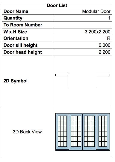

Also....how does that particular door you showed in the brick wall show up on the schedules?
For some background on the object, follow the link I put in my previous post (http://archicad-talk.graphisoft.com/viewtopic.php?t=26789). Essentially, it is a door/window object commissioned by Graphisoft UK to meet the requirements of local architects. It may have broad applications elsewhere too. The object is freely distributed (through resellers) to people on subscription.
The object can represent any number or doors, windows, or panels within a single unit (hence the 'modular' moniker). It was initially designed to cope with doors/windows like those produced by Velfac, which allow practically any combination you like. It's impractical to try to replicate this kind of product with the standard library, and hence the development of this object.
In schedules, this appears as a single item (see attached image).
