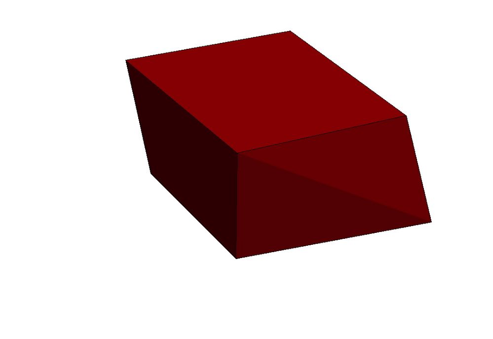

I've attached an example of what I'm talking about. This is an image out of Form Z. Does this help explain what I'm talking about?

Fine.
I'll stay polite and not ask why.
This could be done in a number of ways:
Taking a slice out of a wall or
by using a mesh - you move a top node back from the face a bit.

Sorry for not answering your question before. I am an architecture student and this is part of a project for a design studio. My project has a lot of these "cubes" which are sort of twisted and distorted. The image you show is exactly the end result that I'm talking about. But I may not be able to use that method because I need these to be walls. Just to confirm, you did that using a mesh? Is there any way to keep it as a wall so that I could still punch holes in them for windows/doors?

To do this nonsense as a wall, you would want to make a slightly tilted wall, then use another slightly tilted wall to slice the face away slightly in a "Solid Element Operation." SEO.
Take your time and study SEO.
And Complex Profiles, too since the higher modeling functions, as poor as they are, are best achieved through these tricks.
