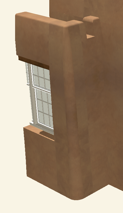

It is possible, although it involves a fair amount of work.
But first, is this what you're looking for?
Jim
James C Lewis
AC 24 (Full)
Mac Pro (Late 2013) OS 10.13.5
James, It's really nice to hear from you. I've come up with another way of doing this: I use the rectilinear walls on an "Ext.Wall" layer so I can use that for dimensioning & creating the C.D.'s of the floor plan. I use a thin Custom Profile for the battered walls (flaring out slightly at the bottom & arching back over the parapet. This Custom Profile is turned on for BimX & elevations. It's a little tedious. Tried morph but that seemed too inaccurate. I'm wondering if there is a better way to do this.
