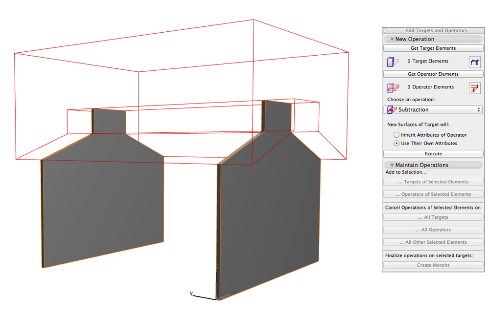

The trick is to create one wall that has the width and height you need.
Then you create a Morph that you will use to subtract (using SEOs) what you don't need from the profile and that you will place in a "hidden" layer.
Since it is one wall you will not have the window problem.
In the attached screenshot I have the morph layer in hidden line mode.

Thank you kindly! Much appreciated. That looks like it will solve my problem. Forgive my ignorance but what is SEO? Im a bit new to morphs in ArchiCAD.
Eduardo Rolon
Solid Element Operations.
Look under Design-> Solid Element Operation
And you can use them with most of the tools in AC not only with Morphs.

I would go with the SEO solution too, but keep in mind that SEO operations on walls do not appear in floor plans. You have to transform them to morph.
I never could understand the reason that we cannot have walls with adjustable heights
James B
As an alternative to SEO, when using Morphs you can use "Merge Elements" from the Connect context menu and Priority Based Connections will become active between the Wall and Morph elements (the Morph will need a Building Material with a higher Intersection Priority)
Another option is to use Shell tool which can create a capping to the Wall - won't need to hide it then. Select both the Wall and Shell and from the Context menu use Connect>Trim Elements to Roof/Shell.

James,
I used your advice and even though I got the desired result in 3d and elevation views, it was still wrong in floor plans.
On the left side of the image that I attached, i used a shell to trim the wall,like you suggested but as you can see the floor plan is wrong, on the right side, I did the same thing but I also transformed the wall into a morph and then it showed up as it is supposed to actually look like.Am I missing something out, or is this like SEO?
James B
On Floor Plan, unfortunately Walls are not 3D projected - like Morph, Roof, Shell and now slanted Columns. So any trim/seo will not appear to affect a Wall on Floor Plan (same with Slabs).

So as I understand, the only way to have walls shown correctly in floor plan is to have them transformed to morph.

Thank you all for the tips. I see what you mean about using SEO's, but I think this would be better served in another scenario, will definitely keep it in mind.
It turns out that the create shell command and connect seems to be the easiest option and works like a charm! in essence I am able to create complex roof forms/extrusions (without affecting the wall properties) and just connect to shell and hide the actual shell object. Pure simple! This option also doesn't affect window placement so in the case of having to resize or change the wall, it becomes quite quick and easy.
This option also doesn't affect how the walls look in plan.
