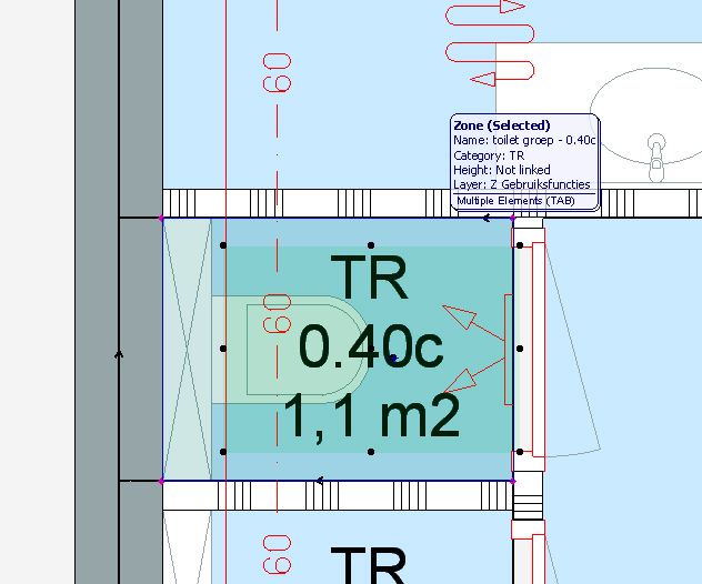

They're not showing when you select a zone? That shouldn't be happening. Maybe update the driver for graphic card.
It should look like the screenshot below.
