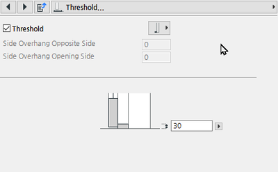

In Korea, fire doors must have a frame underneath. How would you describe it?
This is the best I can do.

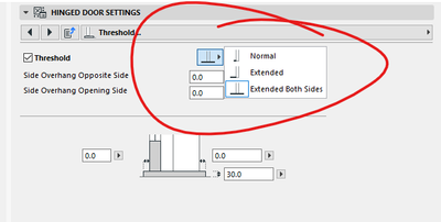

You cannot get the profile with standard Archicad doors, but you can use a double sided threshold with 0.01 extensions and it will look pretty close.

This method doesn't seem to be the way I want it to be.
