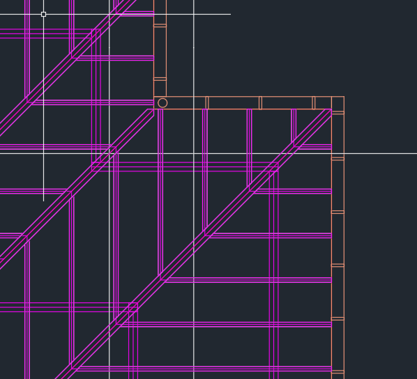

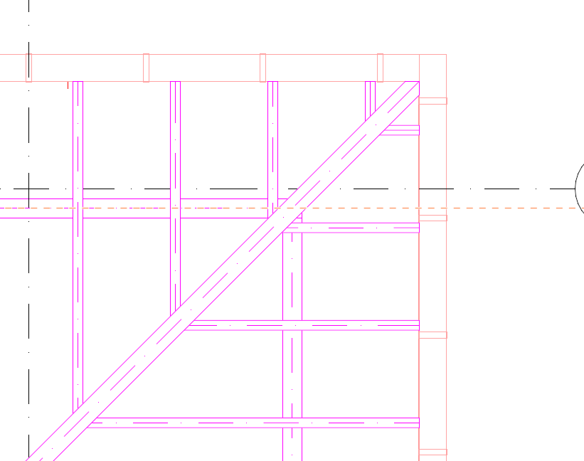

I want to display the background hat as a wipeout in Archicad 29. Is this possible? In the PDF, one object doesn't show up underneath another, but it does in AutoCAD.

It's just a DWG translator configuration.
You could try outputting it as is.

If you the background fill with the pen -1 it will produce a wipout.

What about slabs with holes? In this case wipeouts are not produced, and doesn't produce any other fill either. It looks like wipeouts do not recognise "islands" in the way hatches do.
Do you have any suggestion so that export to dwg looks more like the drawing from AC?
