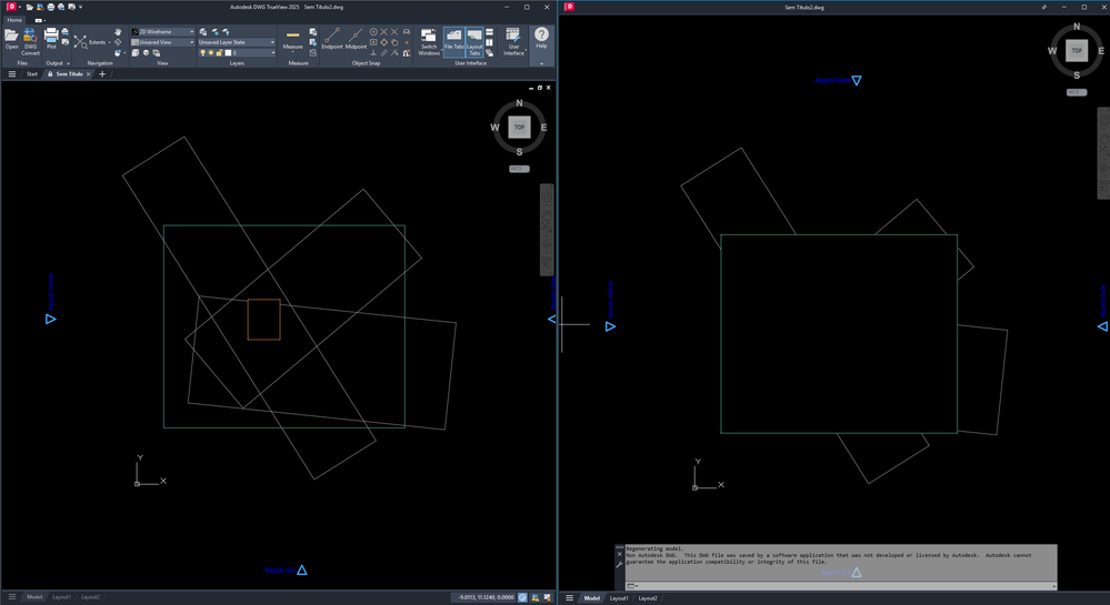

dwg export wipeout
I want to display the background hat as a wipeout in Archicad 29. Is this possible? In the PDF, one object doesn't show up underneath another, but it does in AutoCAD.
1 Solution
If you the background fill with the pen -1 it will produce a wipout.

Hi
It's just a DWG translator configuration.
You could try outputting it as is.

What about slabs with holes? In this case wipeouts are not produced, and doesn't produce any other fill either. It looks like wipeouts do not recognise "islands" in the way hatches do.
Do you have any suggestion so that export to dwg looks more like the drawing from AC?

What kind of holes? Manualy made poligonal holes?
Have you tried the Opening Tool? I'm refering to the one added in AC23, not the window or the door.

I tried both ways: opening tool or manual cutout, and it doesn't work either way. UjIzg2j7ny.png
AC29.2.1 INT FULL, Windows 11 Pro
You are correct.
When the slab does not have the hole, the wipeout works.
When I did the opening tool, the slab wipeout failed.
