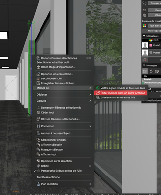

I don't know if other has the problem, but the "edit module in another archicad", which would be super useful while selecting an object in the 3D view, doesn't actually work when I click on it. Would be appreciated if anyone had a solution, or if Graphisoft could solve the issue. Thanks guys ! 🙂

Groups needs to be enabled  for this function to work.
From your screenshot only one column is selected.

Thanks julienK, it's awesome : yes with groups enabled it works well !
